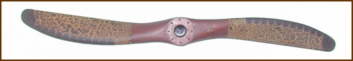

    Here's a picture of an SE5 prop for a 180 built by Curtiss.
    I can measure the diameter if you'd like, but I don't know the pitch.
